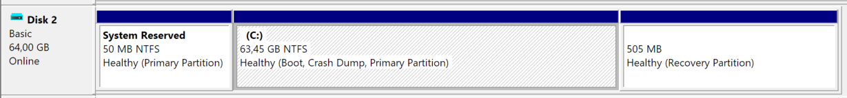

RE: Best way to make a new VHD from a Windows 10 ISO - Midas - 12-21-2020 I have a hunch that Steve2926 has hit the target in his post above where he points that BCD might be the culprit here. E.g., here's the internal disk layout of my Windows 10 VHD, automagically created with VirtualBox under Linux, which boots fine placed on a MBR disk. ![]() That "System Reserved" partition is in fact the EFI boot store and it becomes active only after Ventoy successfully boots the VHD -- prior to that the main boot store is Ventoy's own "VTOYEFI" partition present in the physical boot drive (also hidden). I have gone the VHDX path before, since my go to recipe for installing Windows 7 in a virtual disk apparently didn't work any longer with 10 -- and, at first, everybody just said it couldn't even be done. Bear in mind that, should you decide to try it, you'll be restricted to VHDX under mandatory GPT formatted drives and the new UEFI booting scheme This absolutely won't work with MBR style drives. I have had nothing but endless grief trying to juggle those restrictions under Windows. Best way to make a new VHD from a Windows 10 ISO - romf - 12-24-2020 Midas, thank you for your ideas on this topic. And then thanks to Steve2926 of his idea of using a VHDX instead of a VHD. I gave that format a try today. But I still have no luck. The same error as described in the first post in step 4 shows up. So no matter if I use a VHD or a VHDX-file the partitions look like "Disk 0" on this screenshot, that I found on the Internet: ![]() I noticed that in the VHD-image created by Rufus basically
